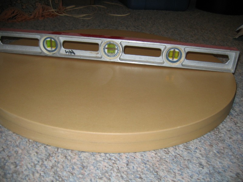

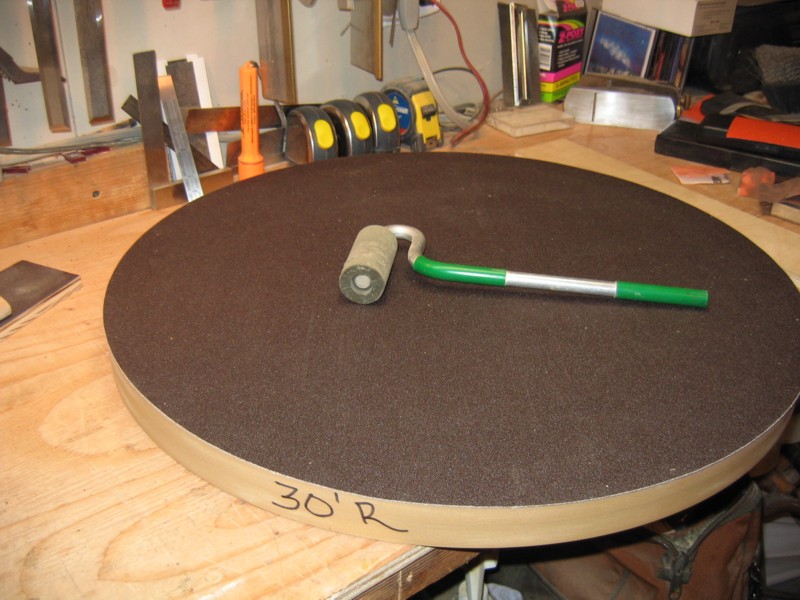

Chris, you should definately do both. The ones I make, that I sell and that I use are two laminations of 3/4 inch medium density fibreboard (MDF). They are 24 inch diamtre and weigh in at about 16 pounds. I use a router to cut the circles and join two discs together before I rout out the dish on the rim sanding machine that I made. So now I have a very stable, laminated and nicely weighted dish with an accurate radius. I then apply two coats of Varathane Diamond Finish. As Michael said, the first coat is just soaked right into the MDF. But the second coat ends up nice and smooth. THey are scuff sanded with 220 grit paper.
So...add another layer AND seal them off. Then you are off to the races! Here's a pic:
And with one piece (a MUST!) sandpaper added
